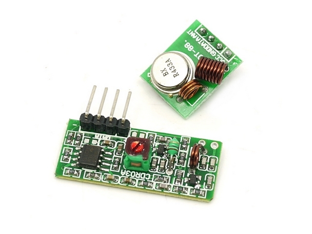

Hi,
i´ve decided to work on some home automation project with raspberry pi, i want to controll all kind of 433MHz Devices like power plugs.
I´ve got no expirience in working with 433MHz senders or receivers and RPi cabling so i decided to do a simple test setup before i start with the real project. I´ll document the test setup here and later the real automation project.
Test Setup
Simple 433MHz send and receive with the RPi
Hardware:
- RPi Rev. B
- 433MHz Modules FS1000A XY-FST XY-MK-5V
- GPIO Breakout Kit, Breadboard and cables
Wiring:
RPi GPIO PINS (Revision 2):
GPIO and PIN descriptions here
Breadboard setup
Please note that my breakout P0 is PIN 11 on Raspberry and P1 is PIN12
Connect sender Module FS1000A:
ADATA: Pin 11 which is BCM GPIO 17 and WiringPi Pin 0
VCC: +3,3V on my breakout (without Breakout use Pin 1 on RPi)
GND: GND on my breakout (without Breakout use Pin 6 on RPi)
Connect receiver Module XY-MK-5V:
DATA: Pin 12 which is BCM GPIO 18 and WiringPi Pin 1 (Dosnt matter which of the both data pins you use)

Didn't you have to use a 5V to get it working? I'm trying to send and receive signals but with no success.. (Didn't follow your tutorial, was just using my own project)
Massi
Posts: 1691
Joined: Fri May 02, 2014 1:52 pm
Location: Italy
Re: Send & Receive 433MHz Signals For Home Automation
Sun Aug 03, 2014 8:36 pm
HeroS_NL wrote:Didn't you have to use a 5V to get it working? I'm trying to send and receive signals but with no success.. (Didn't follow your tutorial, was just using my own project)
yes, you have to give 5V to the transmitter AND to the receiver.
Transmitter data pin can be moved by gpio at 3,3V
Receiver data pin (pins, ok) have to be lowered to be read by gpio (they exit at 5V), so take some resistance and make a partitor..

Does the fact the receiver needs 5V to work properly means it's sending 5V to its data pin?
joan
Posts: 16247
Joined: Thu Jul 05, 2012 5:09 pm
Location: UK
Fri Aug 15, 2014 6:30 am
Bianco wrote:Does the fact the receiver needs 5V to work properly means it's sending 5V to its data pin?
That's the case for the modules I've seen. You should use a voltage divider to convert the data out pin from 5V to 3.3V.

These really are cheap, especially the receiver. I just replace them for these: the range I gained is phenomenal!

A good rule of thumb seems to be:
  • The receiver has a resonator (regardless of its looks: round, rectangular, ...): it's going to have a decent range
  • The receiver doesn't have one: it's a piece of ***

Between the cheap emitter (Arduino) and the cheap receiver (R-Pi), I had around 8 meters of range (using RCSwitch or VirtualWire).
With the new one, I can't measure it without leaving my house. It has to be several dozens of meters.
Night and day, really.

How can this be something not cpu intensive? i think it should go on listening trying to sense a "known" wave form, but this means always listen and always try to match the signal with the known waveform..
More than this, the chinese cheap (an as you say, sh** :D) receiver senses A LOT of noise. I assume that the cheap, but better, receiver senses MUCH MORE noise, isn't it?

Using software decoding, that's gonna be CPU intensive. I guess you could decode with a microcontroller though but that's not a solution I've tried.
It's quite possible the resonator enables it to filter a bit that noise?
I didn't check on piscope: the libraries are handling the noise for me.
Alternatively, you can also buy/build a low pass filter (again, not a solution I've tried).

Bianco wrote:Alternatively, you can also buy/build a low pass filter (again, not a solution I've tried).
mmm not sure about that.
From another topic where we were talking about receivers, it seems that the receiver has a sort of "gain" (lol, speaking as a true noob, take care of this) so that noise you sense when there are no "true" signals is not sensed between close signals (that's why when you send multiple signal between them the line in the oscilloscope is nice and plain..)

Not a low pass filter but a band pass filter, according to the experts at pilight.org:
https://github.com/pilight/pilight_firmware
