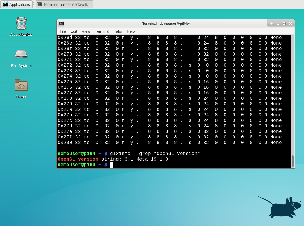

I checked Gentoo (badass distro!) and sure enough Mesa is already at 19.1!

Does that mean anyone who wants to make a Pi4 OS should use at least Mesa 19.1?

Yes.
