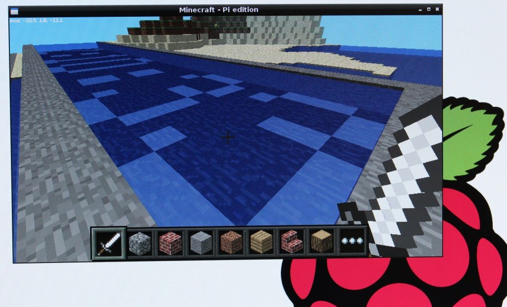

I've done a little more playing with the digital clock concept. This version draws the clock horizontally rather than vertically, and it looks more like an LCD panel meter.
Close view.

Here is the adjust code for the panel meter.
The main changes are building a volume to house the display, and rendering the digits horizontally.
The panel is drawn under the player's feet so it might be a good idea to climb up on a couple of blocks first.

Just for fun I have moved on to a real-time analogue clock now.
I'd say that this one is "interestingly ugly". The still picture does not do it justice. I'll post a video later if I can work out how.
Yes, its just a few seconds after 7:00.
For this project I use PIL (Python Imaging Library) to draw lines and circles. I draw the clock at higher resolution then reduce it for display. It really opens your eyes to the problems that people who draw icons have with limited resolution.
The approach used here could be used for displaying real-world graphs in Minecraft.

Here's a video of the analogue clock ticking.
http://vimeo.com/59559050
