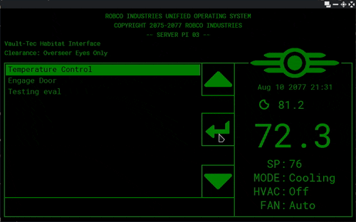

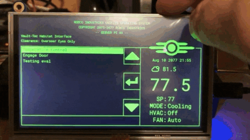

Re: GTK g_timeout_add - issues
What it does on PC...
What it does on Pi
I am re-using the approach I did for my framebuffer version of this application, where the animation frames reside within a tempfs with a specific file structure... within the program I just maintain a list of animations and the list of frame/files for it. example of an animation folder contents ~/D...
