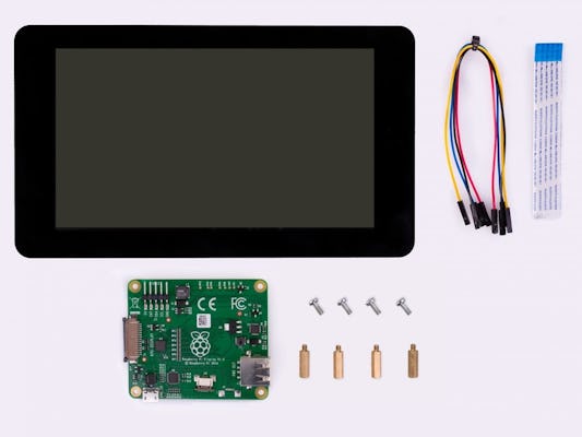

I put 100's of these pi3 cases together and haven't seen this one before. One corner of the display didn't seem like it was seated properly in the case. The other three corners looked ok, the glass was recessed a little bit into the case as was normal, but one corner, the glass was raised up and kind of even with the lip on the case.
I removed the display from the case and didn't see anything unusual. I then noticed that on the bottom of one of the metal mount tabs, I could see where the screw had bottomed out and was pushing against the frame. I looked at the screws and sure enough, one of the screws was a little longer than the other three.
Probably one longer screw got mixed in with the batch of correct screws at the factory. Not a big deal, but I'll look at the case mounting screws a little closer from now on when I put these together.

Were these screws as supplied with the Raspberry LCD panel? It's a little unclear which ones they are.

Perhaps the standoffs' screws
