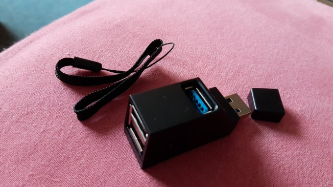

P.S:
Using one USB port for trackball dongle and another for USB wifi is no problem, I do have mini USB3 three port hub if needed:
https://www.amazon.de/gp/product/B08MQH ... le_o07_s00
