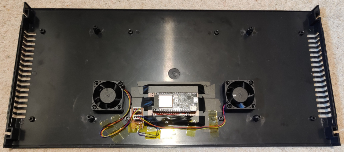

I've been building a little Pi network in a box for the past couple of weeks.
3x Pi 4B 4GB in a rack mountable case, I drilled and fitted standoffs and then cut holes for the ethernet ports into the front;
I put a couple of fans in the lid connected to an ESP32 which I've written some fan control code for, it'll be interfaces to the first Pi by UART.
(I know the ESP32 is overkill for this, but it's the only think I had to hand).
