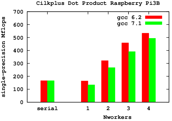

Re: Cilkplus on RPi2B
I wrote a program to compute vector dot products to test the parallel performance of Cilk on the Raspberry Pi 2B computer. The calculation proceeds with a recursive parallel algorithm based on the fact that the dot product is the sum of two smaller dot products involving vectors of half the length. Recursion stops when the vectors reach a certain minimum length at which point a standard serial dot product is used. This minimum length was chosen as 10000 so that the resulting work unit was large enough compared to the parallel overhead for good efficiency.
The environment parameter
CILK_NWORKERS
was set to 1, 2, 3 and then 4 to determine the resulting parallel speedup when computing the dot product of vectors of size 10000000. In this case the recursive algorithm creates more than 1000 different work units that may be executed in parallel, so in theory, the test calculation could scale to 1000 processor shared memory architectures using the techniques implemented here. Note, however, that a dot product involves only one multiplication and one addition for every two numbers fetched from memory and is therefore memory intensive. Consequently this kind calculation possesses a significant challenge for memory subsystems shared by multiple cores.
Tests were performed using both single and double precision floating point. The results were
Memory bandwidth was sufficient to make use of all 4 cores when computing in single precision. The double precision calculation requires twice the memory bandwidth and already saturates the memory bus when 3 cores are active. Thus, parallel speedup for the double precision version was limited to approximately 2.3 fold. For reference, the maximum parallel speedup for double precision on an 8-core Xeon E5-2650 server is about 4 fold.
The Cilk code is pasted below for reference.
CILK_NWORKERS
Parallel Speedup
Cores Single Double
2 1.90939 1.84109
3 2.7171 2.31901
4 3.40789 2.28758

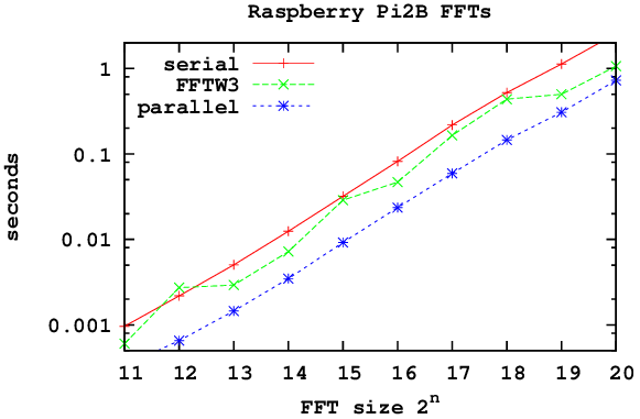

Here is a parallel FFT written using MIT/Intel Cilk. A discrete Fourier transform can be expressed in terms of two Fourier transforms each of half the size. This observation leads to an FFT algorithm which is easy to implement as a parallel recursive routine in Cilk. At modest transform lengths parallel speedup is about 3.4 fold.
Performance of the recursive implementation is reasonable compared to the FFTW3 software library (in single-threaded estimate mode) as seen in the following graph:
For reference, the source code is
The command
$ /usr/local/gcc-5.0/bin/gcc -O3 -Wall -std=gnu99 -fcilkplus -o dfft fft.c -lcilkrts -lfftw3 -lm
compiles this code using the gcc-5.0 build mentioned in the previous post.
./dfft -- Parallel Fast Fourier Transform Benchmark
Precision double FFTs of size 32768
Serial elapsed time 3.118801116943359e-02 seconds
Parallel elapsed time 8.972883224487305e-03 seconds
FFTW3 elapsed time 2.861905097961426e-02 seconds
Parallel speedup factor 3.47581 fold
Eric,
Nice scaling of your parallel cilk FFT code running on the RPI2. I was wondering if there was enough
memory throughput to keep four cores busy. How did you determine the cutoff values"if(s>32||n<1024) {" in
the routine fftparallel? Have you had time to compare the your cilk version of your parallel fft program to a openmp version?
As the your other question:
> Obviously, this instruction is not needed for the original Raspberry Pi, but what happens if it encounters a DSB instruction
> anyway and how does one create a binary that works for both types of hardware?
At some point, I think that Raspbian is going to need to two software packages, one for armv6 (RPI1) and one for armv7 (RPI2).
A lot like what was done with i386 and x86_64 linux packages. GMP would be another good example of a Raspbian package that needs to support two different ARM architectures and it has lots of hand tuned assembly code.
Thanks,
David
Thanks,
David
I chose s>32 because that limits the parallel recursion depth to 6 which is enough to keep most SMP machines busy. I chose n<1024 so the minimum unit of work was large enough to offset the greater costs of cilk_spawn over a regular function call. Both values are somewhat arbitrary and could be optimized using some sort of auto-tuning for different architectures. As noted by Heater indmc1954 wrote:How did you determine the cutoff values "if(s>32||n<1024) {" in
viewtopic.php?p=737161#p737161
the depth first nature of a recursive FFT implementation likely has better memory locality than the essentially breadth first nature of the standard bit-reversal method. From a teaching point of view, the recursive code is also a win because it looks very similar to the mathematical derivation of the FFT algorithm, exhibits the correct asymptotic run-time scaling and is easy to make parallel.
I have not coded an openmp version. Cilk keeps track of pending work behind the scenes using a directed acyclic graph that makes tuning much easier. The primitive cilk_sync waits only for the work needed to proceed with the computation while a single pool of worker threads, one tied to each processor core, steal work from each other using queues. In contrast omp taskwait is global to all threads in the current pool and creating new pools is slow and causes cache contention.
I can see how two versions of certain software packages would be needed to optimize performance. FFTW uses hybrid and more advanced algorithms that should perform much better than my simple code. However, I suspect the FFTW package in Raspbian has been tuned for the ARMv6 architecture of the original Raspberry Pi and is noticeably slower than it would be if tuned for the ARMv7. Since both architectures are 32-bit, this is more like having different packages tuned for 686 versus 486 processors in the Intel world.
People don't usually swap internal HD's from one Intel PC to another, however, swapping SD cards between Pi's is much more likely. I think one of the design principles behind Raspbian is that a teacher should be able move a microSD card from any Pi to any other Pi without problems. The presence of ARMv7 specific packages in Raspbian would break this compatibility. While there are other Linux distributions optimized for ARMv7 that should run well on the Pi 2B, it would be nice to have gcc-5.0 with the Intel/MIT Cilk extensions for parallel processing on the standard Raspbian distribution for teaching purposes. I suppose the way to do this is to compile gcc-5.0 using --with-arch=armv6 and then insert some check into __cilkrts_fence for processor type before issuing a DSB instruction.

I still haven't compared with OpenMP; however, I just translated my parallel recursive fast Fourier transform into the Go language. The Google Go reference compiler installed from the Raspbian repository usingdmc1954 wrote:Have you had time to compare the your cilk version of your parallel fft program to a openmp version?
# apt-get install golang
../gcc-5.1.0/configure -v --enable-languages=c,go --prefix=/usr/local/gcc-5.1 --with-arch=armv6 --with-fpu=vfp --with-float=hard --build=arm-linux-gnueabihf --host=arm-linux-gnueabihf --target=arm-linux-gnueabihf
// COMMON_SYSDEP void __cilkrts_fence(void); ///< MFENCE instruction
# define __cilkrts_fence() __asm__ __volatile__ ("mcr p15,0,%[t],c7,c10,4\n" :: [t] "r" (0) : "memory");
Three executables were produced using commands
$ go build -o pfft fft.go
$ /usr/local/gcc-5.1/bin/gccgo -O3 -mcpu=cortex-a7 -mfpu=neon-vfpv4 -mfloat-abi=hard -ffast-math -Wall -o gfft fft.go
$ /usr/local/gcc-5.1/bin/gcc -O3 -mcpu=cortex-a7 -mfpu=neon-vfpv4 -mfloat-abi=hard -ffast-math -Wall -std=gnu99 -fcilkplus -o dfft fft.c -lcilkrts -lfftw3 -lm
The performance differences may be a result of my unfamiliarity with the Go programming language. Therefore, I would be happy to know of any changes to my code that result in better performance. Note also that the lack of a built-in parallel for loop makes the Go code slightly more verbose.
I cannot really advise on the performance of Go. Only that a year ago or so I wrote the same functionality in Go and in JavaScript running under node.js
To my amazement the JS version was twice as fast as Go! And JS in an interpreted language.
Seemed to me that the Go garbage collector was stopping, starting and and generally stuttering things a lot. I did not take the time to figure out if I could reduce garbage collection issues in the Go version. It was so much easier to do what I wanted in JavaScript.
Of course JS would not take advantage of many cores if they are available like Go can.

Version 7.1 of gcc now automatically builds for ARM with Cilkplus enabled. However, the commandsresult in two executables with performance on the Raspberry Pi 3B given by
The above graph indicates that gcc version 7.1 performs slower. Note that the serial code runs at the same speed for both compiler versions. Theoretically, CILK_NWORKERS=1 should also perform about the same speed as the serial code. This, in fact, is the case with gcc version 6.2 and with the x86 architecture for either version of the compiler. Thus, the regression appears to come from newly introduced overhead for ARM processors related to the Cilk parallel runtime. I don't know what has changed. Maybe the cactus stack is no longer aligned properly or inefficient code for saving and restoring the floating point state has been added. As I'm using Cilk to teach parallel processing in my classes, it would be wonderful if someone could look into what has happened.
For reference the C code for the above tests is given by dotprod.cby bench.hand by bench.cSimilar performance issues are obtained with my original dot product code as well as using any of the other parallel codes in this thread.

I just filed a bug report at the gcc bugzilla site about this performance regression. The reply I received indicated that the MIT/Cilkplus parallel processing extensions to the C programming language, which were added to gcc version 4.9 in 2013, have been deprecated and will be removed from gcc starting version 8.0. Apparently there was not enough support or expertise to maintain the code that was originally contributed by Intel. Fortunately OpenMP now includes task-based scheduling similar to Cilkplus that will continue to be supported. As a result, conversion of the examples contained in this thread to OpenMP should be straightforward, though preliminary results indicate slightly reduced performance. I'll eventually start a new thread comparing the two.
