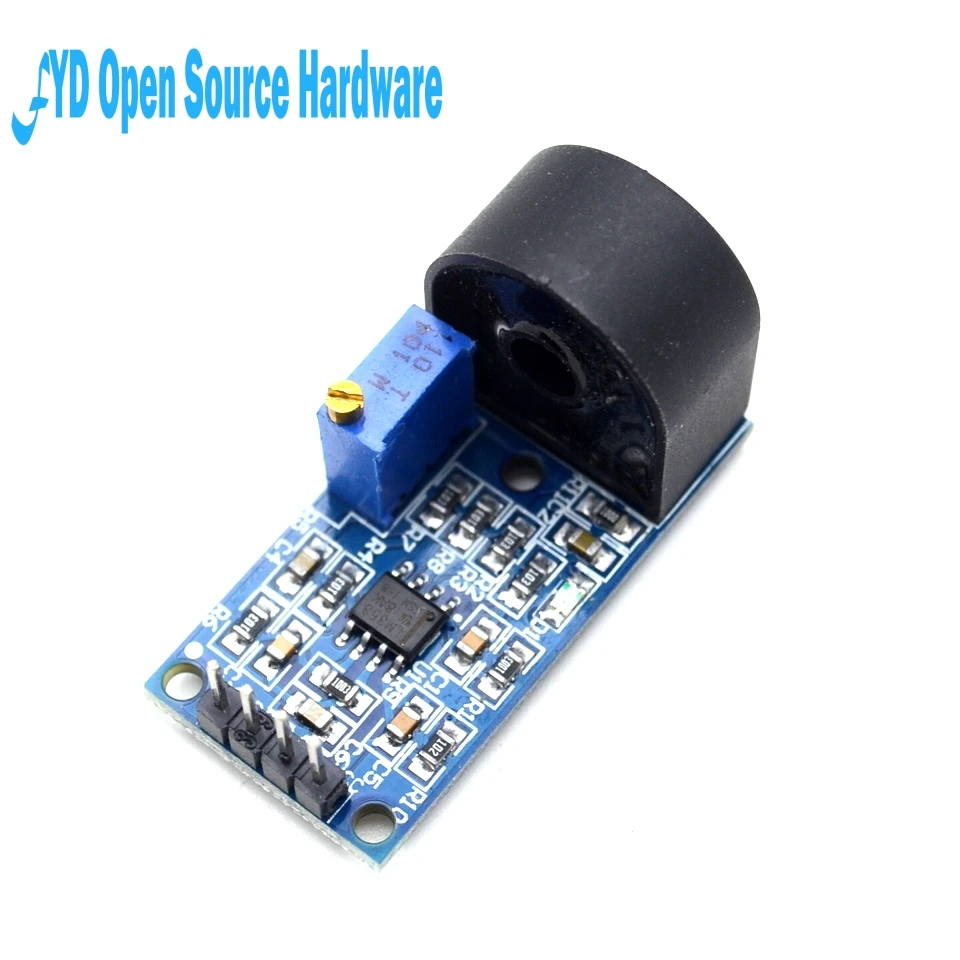

Easy. You just add wire and loop mains lead around one and with little more than cap and resistor interface directly to GPIO. Even cap is not really required if you don't mind tweaking a pot. Full isolation and cheap as chips. If you want to measure actual levels instead of on/off then add ADC.
Here's an example of mains interface that uses these. I have several in operation around the house. For Pi you don't need the meter part, just the ferrite/coil and they can be purchased separately for less than 1/10 the cost. Smaller versions even cheaper.

There are lots of this style of breakout board around these days:
They have an adjustment to set a dugital output at a chosen current level and also have an analogue output alongside it.
They are also available with terminal block for wired toroid ring (as Emma1997 has shown) instead of having the toroid ring integrated into the board.
Doug.

In the environment that I now work in, we use these to sense the presence of current. I'm primarily posting this because devices with an integrated closure output are available, not because they are cheap. Shop around. The output is solid state (Form A contacts in this case, not an analog output) and has a low threshold. Super easy to interface to a GPIO pin.
https://www.veris.com/ASSETS/DOCUMENTS/ ... 0_i0g2.pdf
