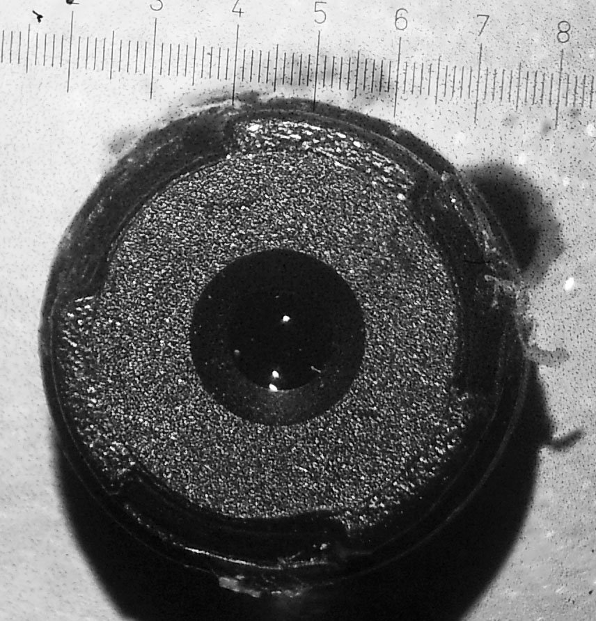

towolf wrote:Can you advise how to measure the pupil properly?
You can start with just measuring the diameter of the aperture in the front. In general for lenses this may or may not be the actual pupil, but it certainly is an upper bound because nothing further back can enlarge the appearance of the front aperture. In the case of these simple lens designs, however, the front aperture *is* the entrance pupil, unlike an SLR lens where the aperture stop is a mechanical iris further inside the multiple elements.
The entrance pupil is defined to be the *image* of the aperture stop as you see it looking in from the front. That is, what is the smallest passage limiting (stopping) the light getting through the lens to the sensor. Since this can be inside the lens behind some glass when there are multiple elements, one must measure how the aperture appears from the front, when refracted by any intervening glass. On an SLR lens the aperture stop is the iris providing f/stop adjustment in the middle of the lens. In this little Raspberry Pi fixed lens, the aperture stop is just the front opening.
On the human eye, the pupil created by the iris is the entrance pupil. It is actually smaller in size than it appears, because you only see it magnified by the cornea. This apparent diameter is what determines the f/stop of your eye.

I fail at making consistent measurements, but this pretty much confirms ~ 1.25mm.

towolf wrote:... this pretty much confirms ~ 1.25mm.
Thanks, nicely done. This lens looks like mine.

@ RKinch
Just photographed my RPi camera lens and obtained the following:
Camera Body (measured with vernier calipers): 7.96 mm +/- 0.02 mm
Camera Body (Pixel Count: 1209 - 618 = 519 +/- 2): 7.96 mm
Lens (Pixel Count: 964 - 870 = 94 +/- 2): 1.27 mm
Looks like 1.25 mm is within the error bounds. The lens assembly looks very similar to yours and the one posted by fastmapper.
For reference, photograph taken with Nikon D3100, 55 mm Focal length, f/5.6.
Hope it helps.
