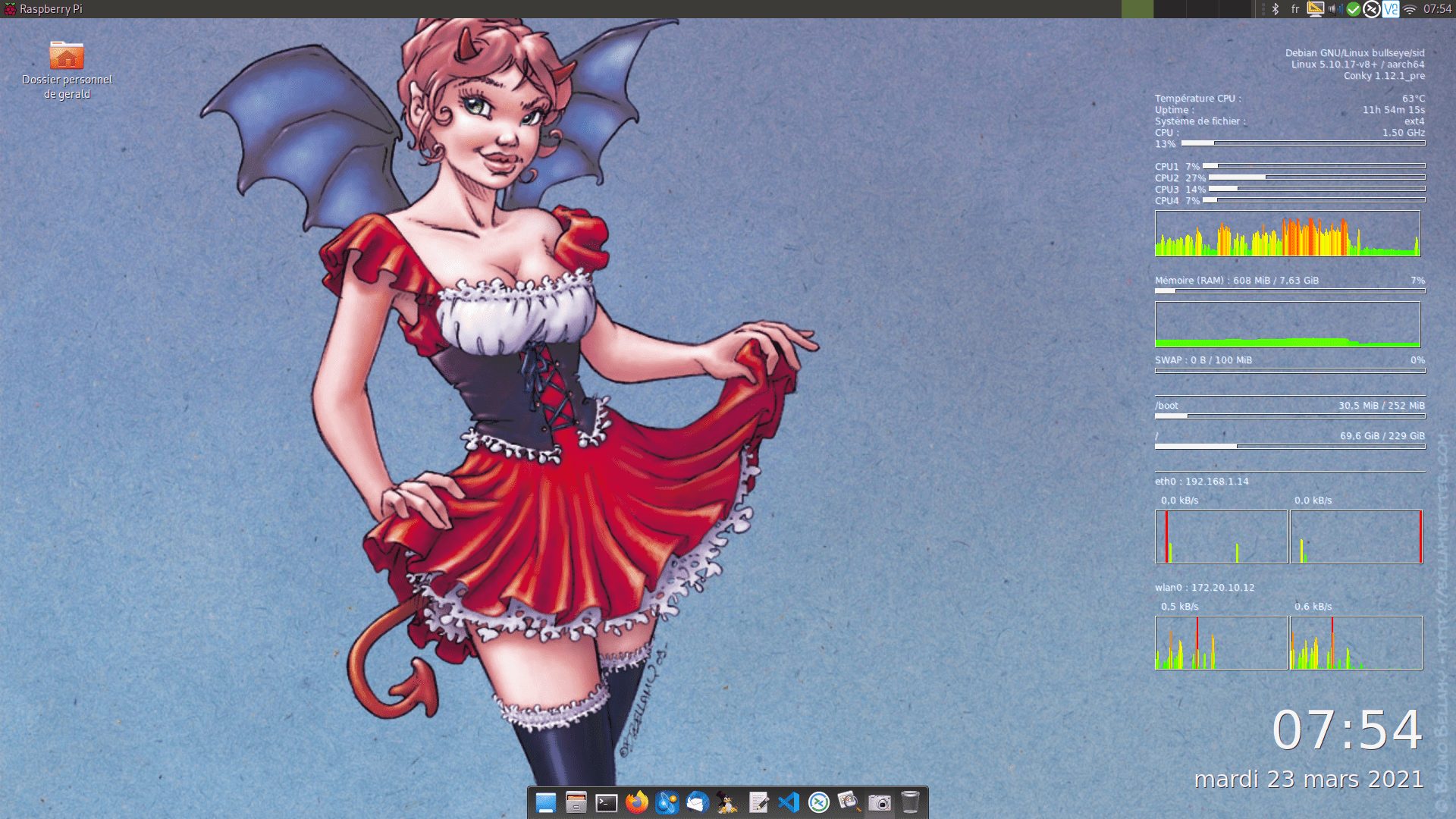

Tue Mar 23, 2021 7:03 am
- Rasi OS Lite 64 bits
- Upgrade to bullseye
- Mate Desktop
- Theme by Ubuntu-Mate-Artwork
conky.config = {
	use_xft= true,
	xftalpha= .1,
	update_interval= 1,
	total_run_times= 0,
	background = true,
	alignment = 'bottom_right',
	double_buffer = true,
	default_color='whitesmoke',
	default_shade_color= '333333',
	default_outline_color= 'black',
	color1 = 'DimGray',
	font = 'Ubuntu:style=medium:size=9',
	gap_x = 40,
	gap_y = 20,
	maximum_width = 400,
	minimum_width = 350,
	own_window = true,
	own_window_colour = '000000',
	own_window_type = 'override',
	own_window_hints = 'undecorated,below,sticky,skip_taskbar,skip_pager',
	own_window_transparent = true,
conky.text = [[
$font${color1}${alignr}${exec lsb_release -d | cut -f 2}
$alignr $sysname $kernel / $machine
${alignr} Conky ${conky_version}
Température CPU : $alignr${hwmon 0 temp 1}°C
Uptime : $alignr${uptime}
Système de fichier : $alignr${fs_type}
CPU : $alignr$freq_g GHz
${cpu}%  ${color}${cpubar}
$font${color1}CPU1  ${cpu cpu1}% ${color}${cpubar cpu1}
$font${color1}CPU2  ${cpu cpu2}% ${color}${cpubar cpu2}
$font${color1}CPU3  ${cpu cpu3}% ${color}${cpubar cpu3}
$font${color1}CPU4  ${cpu cpu4}% ${color}${cpubar cpu4}
${cpugraph 60,349 00ff00 ff0000 -t}
$font${color1}Mémoire (RAM) : ${mem} / ${memmax} $alignr ${memperc}%
${color}$membar
${memgraph 60,349 00ff00 ff0000 -t}
$font${color1}SWAP : ${swap} / ${swapmax} $alignr${swapperc}%
${color}$swapbar
${hr}
$font${color1}/boot $alignr ${fs_used /boot} / ${fs_size /boot}
${color}${fs_bar /boot}
${voffset 10}$font${color1}/ $alignr ${fs_used /} / ${fs_size /}
${color}${fs_bar /}
${hr}
$font${color1}eth0 : ${addrs eth0}
${voffset 10}${template1}  ${downspeedf eth0} kB/s ${goto 185}${template0} ${upspeedf eth0} kB/s
${color}${downspeedgraph eth0 70,174 00ff00 ff0000 -t} ${upspeedgraph eth0 70,174 00ff00 ff0000 -t}
$font${color1}wlan0 : ${addrs wlan0}
${voffset 10}${template1}  ${downspeedf wlan0} kB/s ${goto 185}${template0} ${upspeedf wlan0} kB/s
${color}${downspeedgraph wlan0 70,174 00ff00 ff0000 -t} ${upspeedgraph wlan0 70,174 00ff00 ff0000 -t}
${voffset 15}
${alignr}${font Ubuntu:style=Medium:pixelsize=70}${time %H:%M}${font}
${voffset 5}
${alignr}${font Ubuntu:style=Medium:pixelsize=30}${time %A %d %B %Y}${font}
