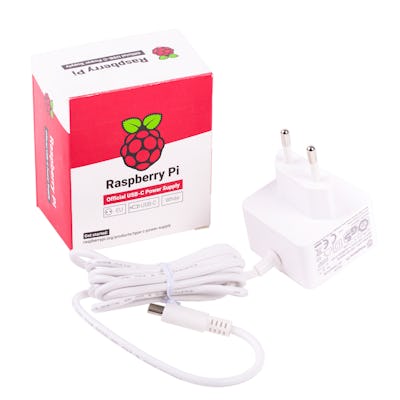

For a raspberry PI 4, or 400 you need an adapter that can deliver 5.1V at 2,5A, with an USB-C connector, like this official one:
with this connector
Note that early Raspberry PI4's did not work with some "smart" adapters (notably for apple products) as they could not correctly negotiate the output current, this was corrected after a few months, and newer RPI4's and RPI400's work correctly with such adapters.
