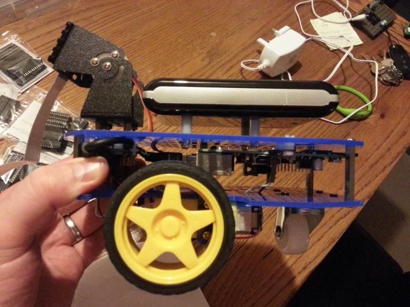

I've been having fun putting mine together over the last few weeks since getting one of these at CamJam, just doing a little bit here and there.
I like how it is kind of 'ready to go' with the downloadable image and the interface already configured. Whilst I'm not normally keen on things that do all the hard work for you, I'm using this as something to get me started with robotics as I had avoided it so far as it looked a bit complicated.
Having it all there working means I can go in and look at the code, change stuff, ask questions on motors, amps, current and all the other motor/robotics related stuff and learn as I go - rather than doing it from scratch and quickly losing interest because I'm so impatient :lol: The other thing I love, probably related to me having a few RC cars back in the day, is the way you can change the layout of the robot parts and use different power sources.
Here's my current setup - I mounted the Pi and driver board upside down inside the two chassis plates - then broke into my powerbank, drilled some holes, and now have it properly mounted on top. I also removed the first servo so it's mainly front tilt view with the camera, and I'm going to use the other servo elsewhere on the robot once I can think up something cool...any ideas?

Nice,
I don't think I've ever seen anyone else assemble the kit in that way, but it certainly shows the flexibility of the chassis. :)
I can't think of any massively functional uses for the servo, but you could give your robot a tail, and then wag it when the robot is 'happy'. Perhaps combine it with the camera and OpenCV to wag the tail when it sees someone's face?
The Tamiya TL-01 looks interesting, looks like the throttle motor is a brushed DC motor so you should be able to connect this up to ML or MR on the mini driver, you could then attach the steering servo in place of either the pan or tilt servo.
