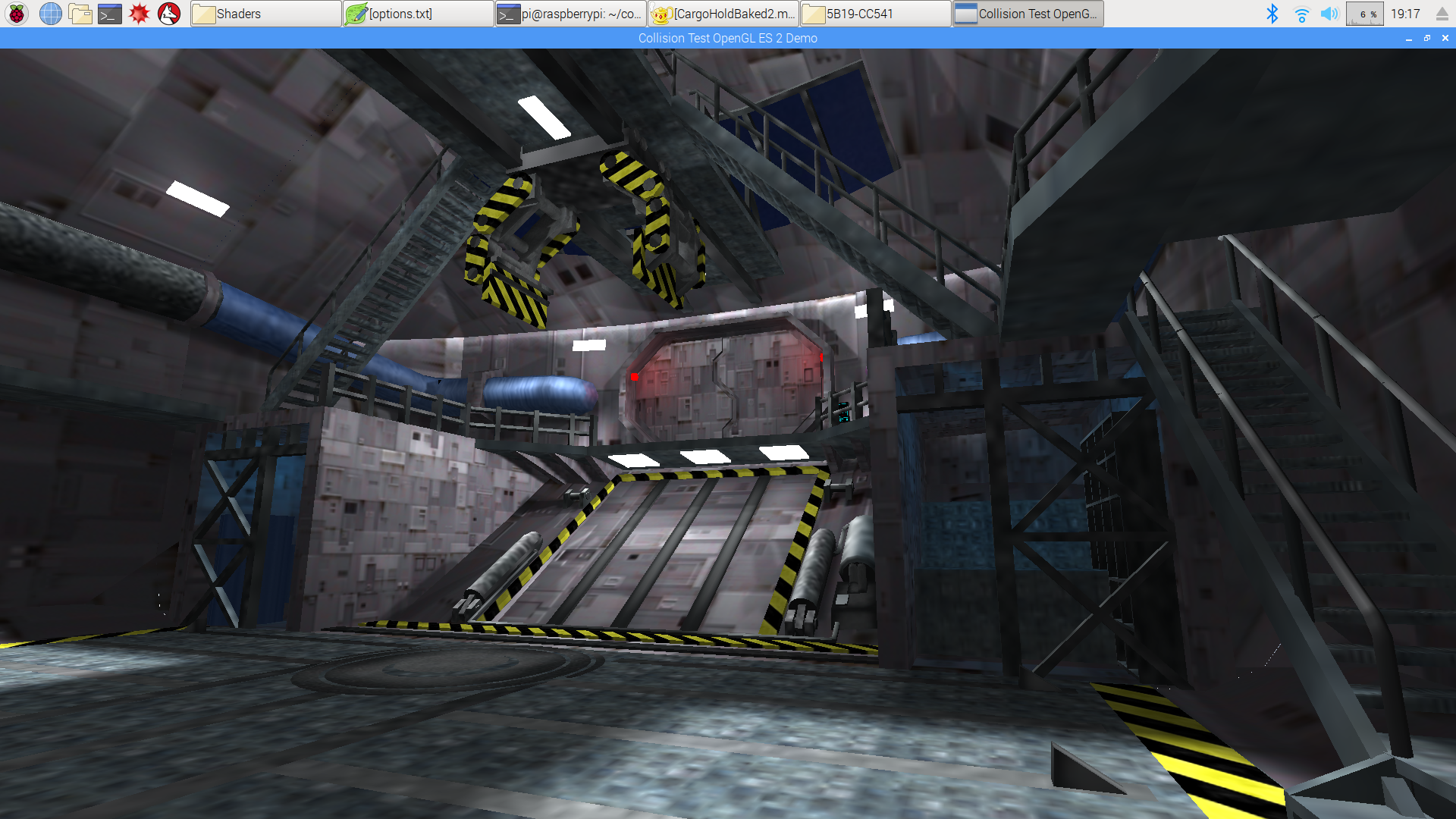

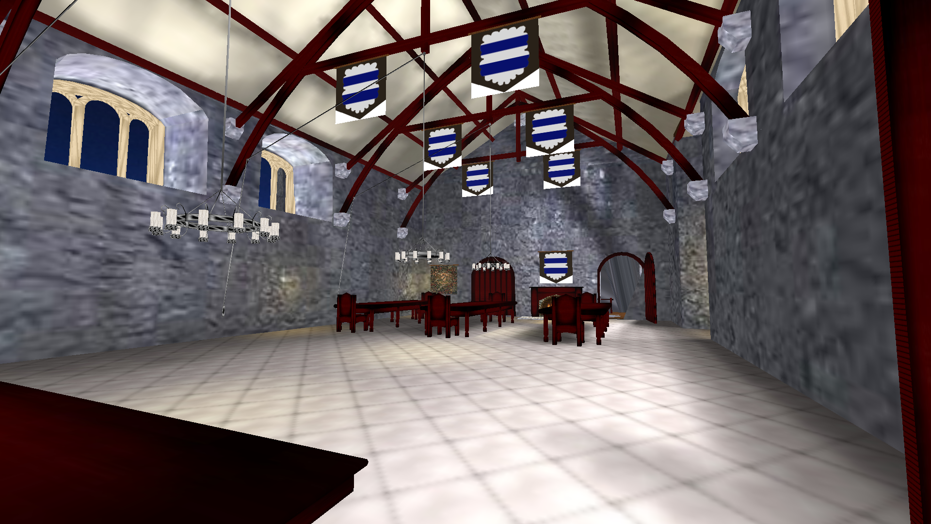

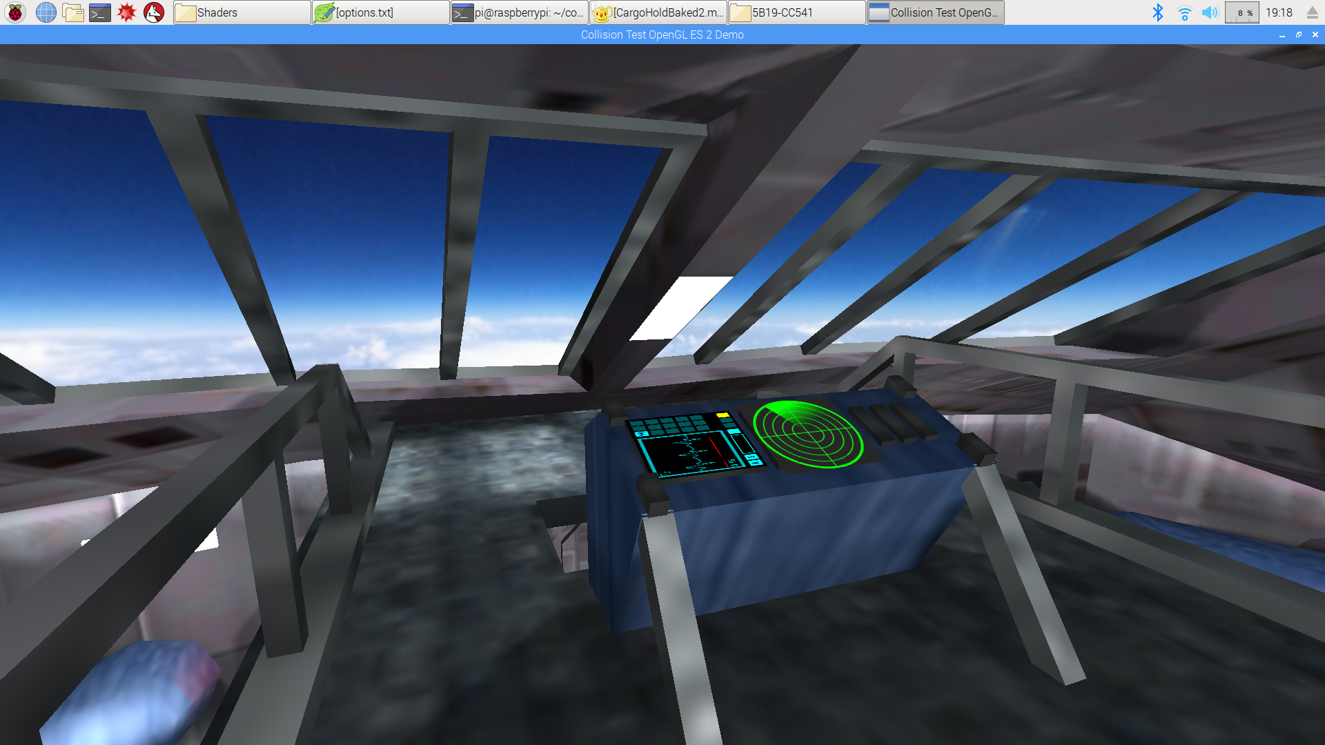

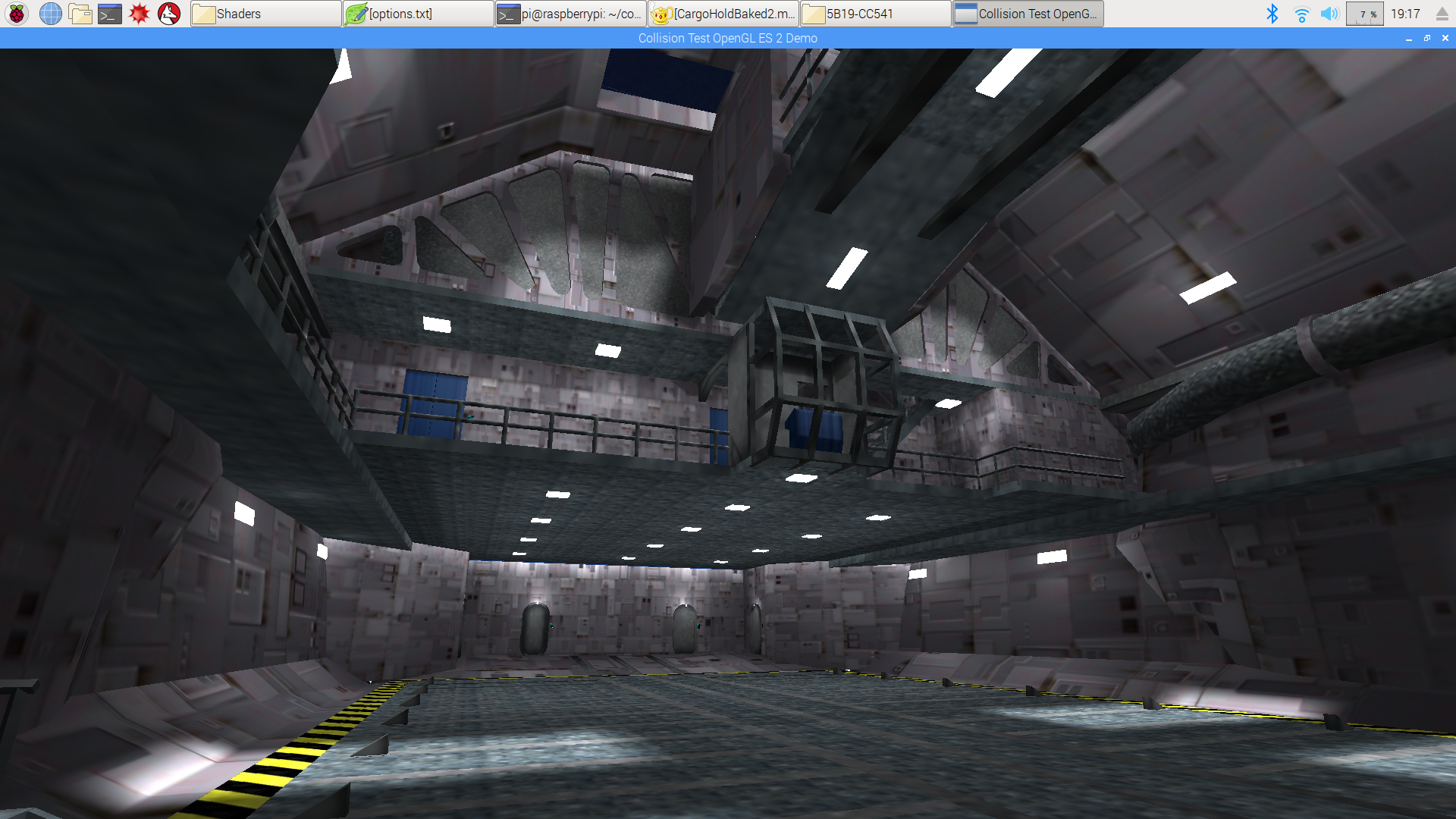

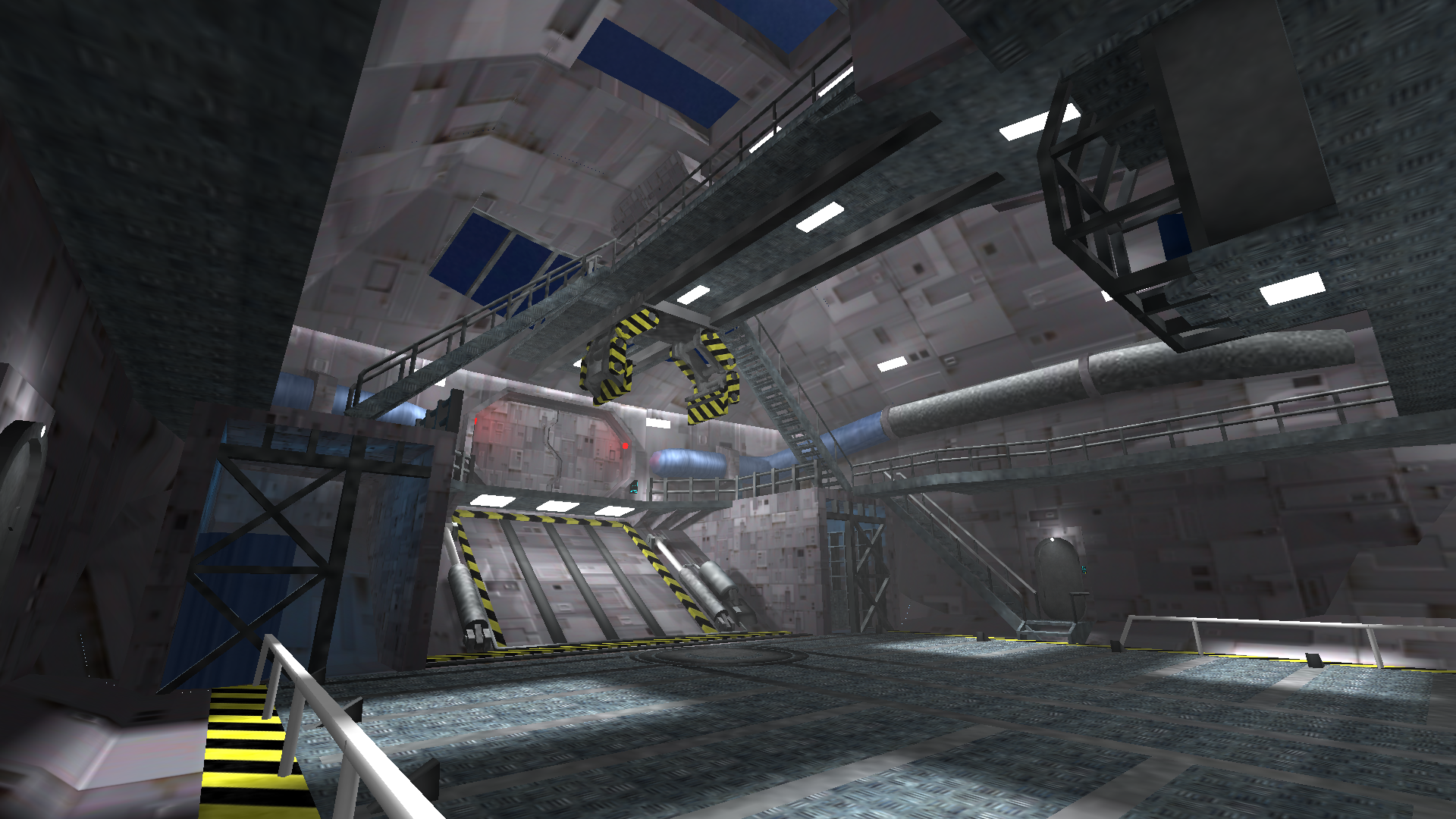

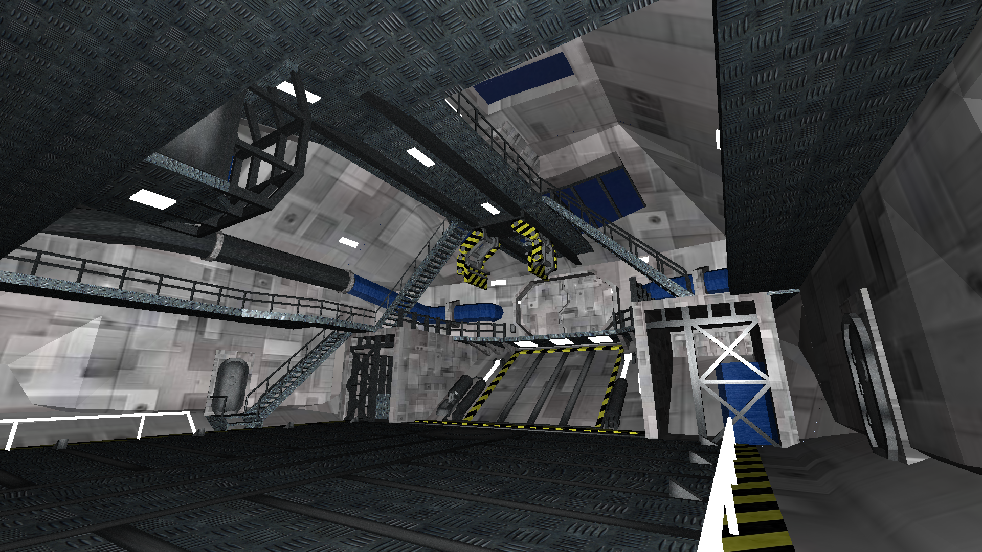

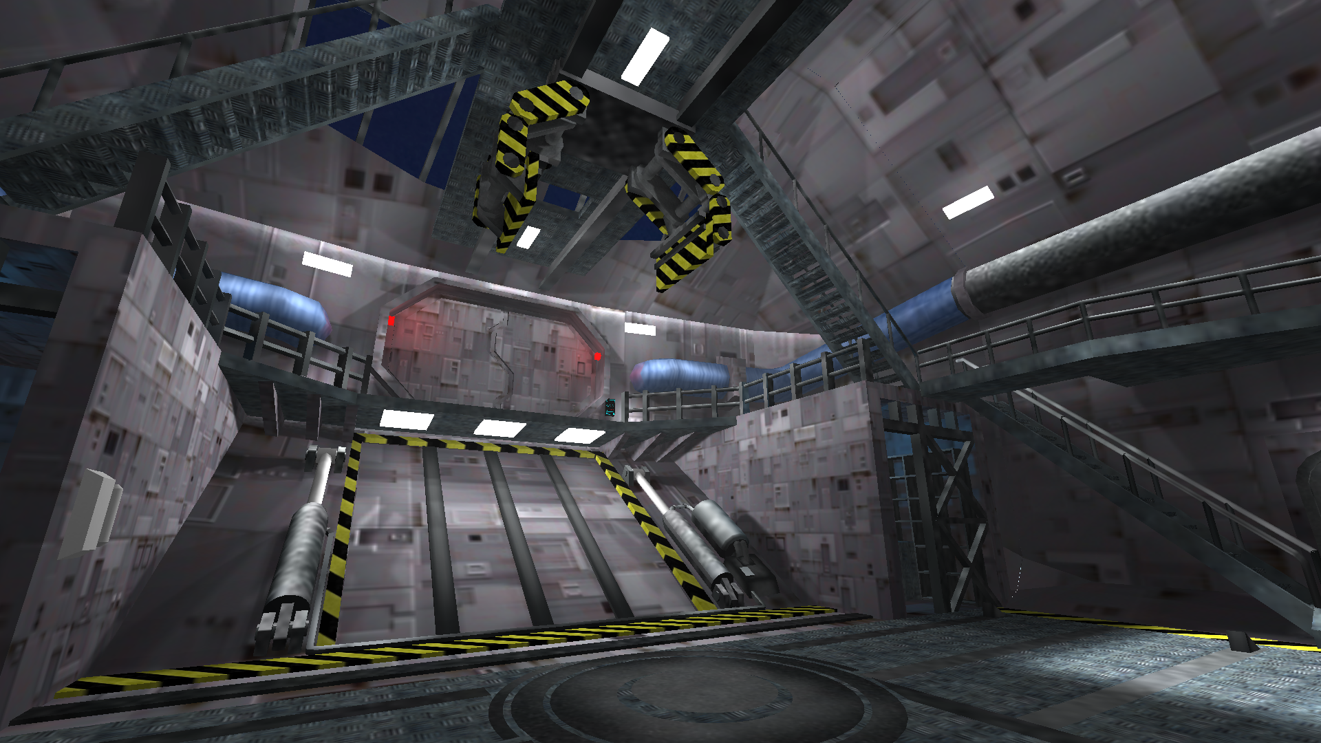

Baked texture update ...
Finally UV unwrapped and created the baked texture (and light maps) for the Cargo bay ... here are the improved results including a quick video of how it runs ...
https://youtu.be/0tkeIJXGCxU
Raspberry Pi == small computer == big dreams
Re: Star Citizen on the Raspberry Pi?!
Tim, that's really great. Not sure it's relevant but it did occur to me that one could use the full float range to pack two UV texture coordinates into each value i.e. split into frac() and floor() in GLSL. We used that in pi3d to get x, y, z, size, rotation, r, g, b, a, u, v, into the 8 float values of the standard array buffer for the point text system (and for the multiple texture elevationmap shader). Of course the resolution has to be slightly limited but that might not matter for shadows.
You mention in the video that there's full collision detection - is that just in z direction or are you checking x and y too now?
also https://groups.google.com/forum/?hl=en-GB&fromgroups=#!forum/pi3d
Yes, it would be good to pack the array as you suggest - I need to take a look at the Pi3D shaders for inspiration! You've got some great shaders in there. My fragment shader is very simple; it did have fog and other experiments, but it's currently like this .....paddyg wrote: ↑Wed Jul 04, 2018 9:52 pmTim, that's really great. Not sure it's relevant but it did occur to me that one could use the full float range to pack two UV texture coordinates into each value i.e. split into frac() and floor() in GLSL. We used that in pi3d to get x, y, z, size, rotation, r, g, b, a, u, v, into the 8 float values of the standard array buffer for the point text system (and for the multiple texture elevationmap shader). Of course the resolution has to be slightly limited but that might not matter for shadows.

Yes, it does floor collision and forward vector collisions at foot and head positions - could still do with some improvement thoughYou mention in the video that there's full collision detection - is that just in z direction or are you checking x and y too now?
That's pretty good, doing the collision detection on the mesh. Tricky doing the horizontal component and coping with things like railings or tables.
The shader is quite simple and will be fast but it gives a very good effect - it's a really sensible idea to use baked shadows. I found that, on the raspberry pi at any rate, if() blocks get executed whatever the result of the condition, just that the result gets discarded. Often it seemed faster to use the condition variable (u_illum, say in your code) in subsequent mix(), step() or smoothstep() calls. (Also, I suspect the compiler already does this for you, but you can sub your second dot() with rDotV.)
The pi3d shaders suffer a bit from an early design decision (on my part) to get the GPU to do the matrix inversion to put the light vector into the object frame of reference. Normally this is done by the CPU and passed as a uniform variable matrix. I thought that python would struggle to do the calculation (c.f. C or even java) however that was before I discovered the speed of numpy, maybe I ought to revisit it!
