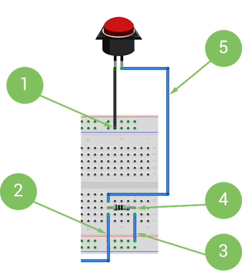

They are connecting 5V to one side of the solenoid coils and the switch pull-up.
That's not correct. Read what I had to say about it (immediately above your post).

I think you are mistaken there. Take another look at the Fritzing diagram. The button is shown with a black wire to the blue rail of the breadboard and that rail is shown connected to GND on the Pi header. The other side of the switch has a blue wire going to the gpio input and a pullup resistor.
I don't. Look at how the bottom row of solenoids are connected, then observe that the top row are indeed connected to 0V but the wire is shown as if stripped at the end (as is the red wire, indicating it is intentional that the positive side goes to the GPIO).
However, I have just noticed that five of the six diodes are shown the wrong way around (it just happens that the one I looked at is correct), so five of the six solenoids wouldn't do anything as shown anyway!
I did miss those green lines. Is that a quirk of Fritzing a deliberate attempt to convey information, I wonder?
Coils commoned to 5V would fit with the polarity of all but one of the six diodes. The diodes are wrongly connected in any case. They should go across the coil, not in series with it.
The button is clearer and definitely seems to switch to GND with a pull-up to 5V. Still bad practice.
I already said that.
PiGraham wrote:
Fri Jul 13, 2018 9:13 am

Soo we're probably stuck again.
We got the ULN2003APG and followed this diagram https://imgur.com/a/cXkL5Wq on youtube except we didn't use the headers. Unfortunately the switch works on LEDS but not on our solenoid(We tested solenoids again because it was hard to find 12v batteries for the relays).
Our solenoid right now draws 180 mA at 3v but when we tested it on the circuit with the ULN it was only pulling 10mA. I'm not sure if this a problem with the type of component we bought or a problem with the circuit diagram we're following.

Do you have any resistors in sries? The diagram shows LEDs with current limiting resistors, as needed for LEDs, but you don't want to add resistance to the solenoid circuit.
What voltage do you measure at the ULN pin when the switch is on? What voltage do you measure at the battery +ve terminal when the switch is on?
According to [ur=https://toshiba.semicon-storage.com/ap- ... 03APG.html]the datasheet for that particular part number
[/url]
Input voltage VIN (ON) ULN2003A 2.8V(output on) (IOUT = 400 mA)
So Pi gpio output high should be at least 2.8V and the device should be abale to pass at least 400mA
However, Collector- emitter saturation voltage is given as 1.3V max so you may only have 2V across the soil if driving from 3.3V. Try increasing the solenoid supply voltage.
