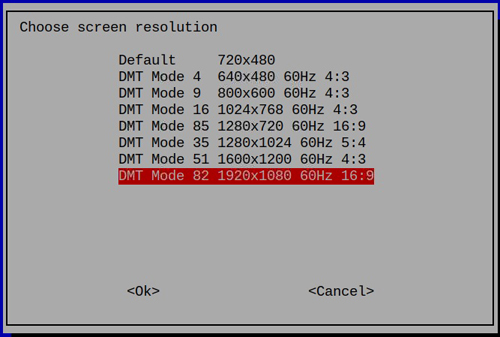

Re: [VNC] Cannot currently show the dekstop
I have a problem when I can't vnc-connect to the raspberry pi after unplugging the HDMI-cable. It works fine with VNC Viewer (from a MacBook) and VNC Server (on my raspberry pi 4) when HDMI-cable is connected.
I got it to work again after this steps:
ssh into the pi
sudo raspi-config
- choosing 7 Advanced options
- choosing A5 Resolution
- choosing Default 720x480
- rebooting
- trying to VNC
- failed with the same error message
- repeating the ssh
- going into raspi-config
- changing resolution to
- DMT Mode 82 1920x1080 60Hz 16:9
- rebooting, connecting with vnc
Then it worked again. Welcome to Linux, everything must be tinkered with I suppose.

I then set the resolution with raspi-config:
I set it to: DMT Mode 82 1920x1080 60Hz 16:9
When I ran VNC on my PC the desktop came up OK for my Pi
After getting it to work on my Pi 4B I wanted to investigate it further.
Here are the available resolutions shown with raspi-config:

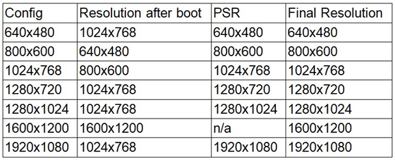

With a lot of experimentation I found I could set all the resolutions with raspi-config and have the desktop show up with VNC on my PC only with an extra step. The exception was 1600x1200.
1. Set the new resolution with raspi-config
2. Reboot
3. Also set the new resolution with Pi Menu > Preferences > Screen Resolution
Config = raspi-config > Advanced Options > Resolutions
PSR = Pi Menu > Preferences > Screen Resolution (aka ARandR)
Final Resolution = xrandr -q

I set the resolution with: Pi Menu > Preferences > Screen Resolution
I set it to: 1920x1080 @60Hz
When I ran VNC on my PC I got the message “Cannot show the desktop”
2. Reboot
'Man in a van' solution is the simplest. It automatically adds to the config.txt. For ready reference I copy it here:
sudo raspi-config
Select 7 Advanced Operations
Select 5 Resolution
choose highest available.
After rebooting if you check the config.txt, you will notice
hdmi_force_hotplug=1
hdmi_group=2
hdmi_mode=82
sudo raspi-config
Select 5 Resolution
hdmi_group=2
hdmi_mode=82
