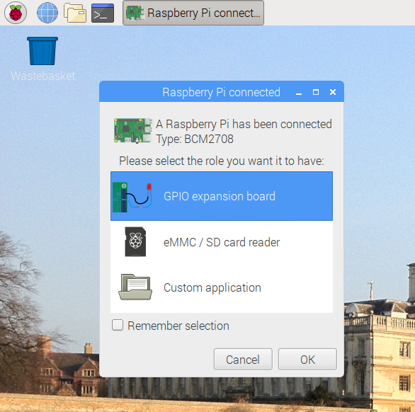

May also want to mention in the docs that if you have a normal Pi running Raspbian, you can also just connect the CM board by USB and select the second option from the following pop-up screen you will get:
Can then dd your image to the new drive that will appear.
