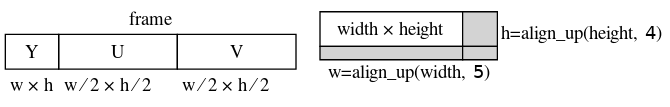

Yes, in a way it is reimplementing gstreamer. Passing dmabuf's is not needed, since Raspberry camera framerates are seldom above 100fps, and 10ms is more than needed. Also bash piping is no problem with 100fps. I have written gstreamer plugins in the past, very steep learning curve, and then some things just cannot be done.
With i420toh264 a plugin just reads a frame, processes it, and then output the (modified or not) frame.
It can do whatever is needed, eg. control stepper motors of pan/tilt camera system using pigpio C interface.
Nothing to learn for writing your first plugin, just the structure of a i420 yuv frame:
Looking into the examples in the repo helps for a fast start -- just try it.
This simple modifying example converts recorded color video to grey by setting all U and V values to 128, leaving only the input Y luma plane:
https://github.com/Hermann-SW2/userland ... yuv2grey.c
