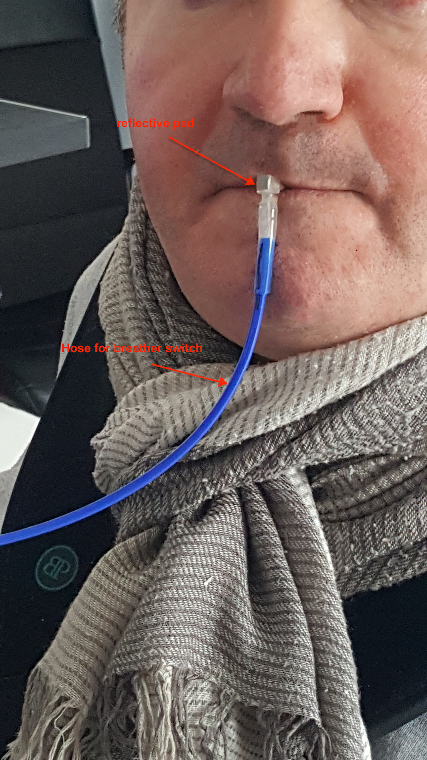

I will prove to you that yes. Look at the image below, this is the current system I have. If you look closely, the reflective pad is placed on a plastic tip which is connected to a pipe for a breath switch. When I arrive in front of my computer, I just have to position the pipe in the mouth. When I want to stop doing computer work, I just have to drop the pipe from my mouth. I have no equipment on my face or on my head. You understand why I'm looking for something with a reflective pad because it doesn't take up space and is very practical to use

Excellent photo. And makes sense when put together with your first post.
In some ways I am disappointed that this is the best we can do to help people use computers. On the other hand, if this system works well for you I can understand why you want to replicate it, so that you can carry on uninterrupted if the current system should fail.
So, we should probably re-visit the content of this thread with this new, and clearer, information.

ame wrote:
Tue Apr 18, 2023 8:37 am
If I try to reproduce it, it is because unfortunately it is no longer developed. And what I'm afraid of is breaking down with it and ending up without emergency equipment. So I'm looking to provide something that in case of failure I can continue to make the computer.
