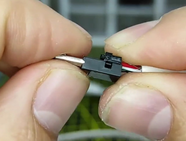

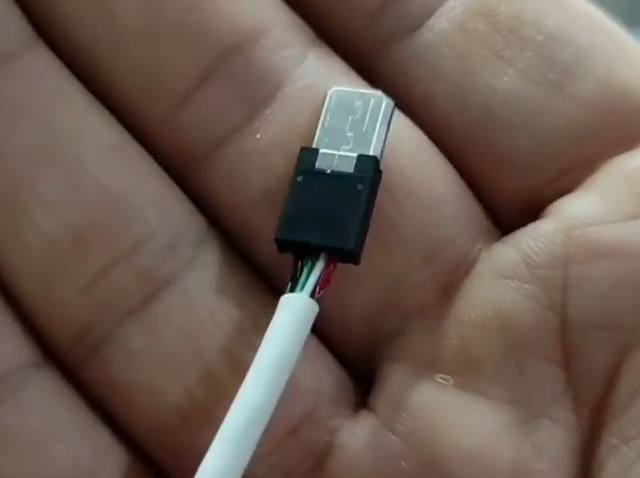

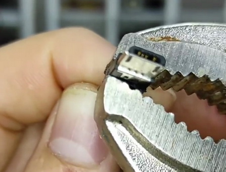

On the other hand, on a video, I saw this:
It seems to be a Self-Crimping MicroUSB Connector,
you insert the 4 wires into 4 holes, like you do with an RJ45 plug,
and after the wires are in, you bring another part of the connector, press it in using plyers,
and it's done..
No need to struggle with soldering tiny solder pads,
and also you get a much stronger holding of the wires than solder pads.
BTW,
the pictures don't show it,
but there's a cover that comes after the self-crimping,
so it looks like a really neat connector.
So my question:
Does anyone know where such MicroUSB Male plugs can be purchased?
They seem to be a really useful tool for converting USB-A devices to nicely fir the RPi 0 or 0W..

That does look neat. I've only used solder connectors and they can be a bit fiddly at times.

You could buy a hub with a microusb connector:
https://m.aliexpress.com/item/1005004069485479.html
Or a USB to microusb shim:
https://m.aliexpress.com/item/1005003974376473.html
A solderable microusb connector:
https://m.aliexpress.com/item/1005004232854399.html
Or you could type "microusb crimp" into Google and find this:
https://m.aliexpress.com/item/32826516371.html

Right.
Also, in addition to the tiny solder pads which are more difficult to solder,
some plugs are manufactured from a really low grade plastic,
and when you solder the pads, the plastic melts, thus ruining the plug..
And when you buy it you cannot know beforehand what you're going to get..
Is it good plastic that can stand heat, to will be a nightmare :)

Great!
Thank you so much
