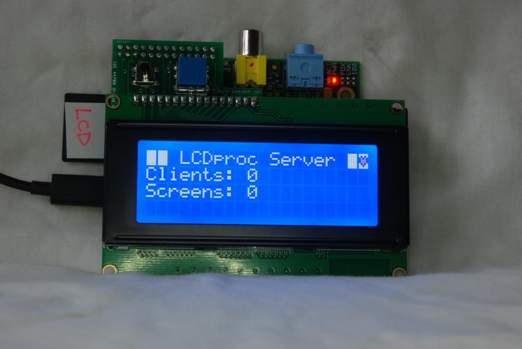

Instructions for basic setup and configuration of my I2C driven LCD board.
Configuration details for LCDproc and/or Raspbmc can be found here : http://www.raspberrypi.org/forum/viewto ... 35&t=63412
SSH into the pi and install smbus and i2c-tools :
sudo apt-get update
sudo apt-get install python-smbus i2c-tools -y
Enable i2c on the pi :
sudo nano /etc/modules
and add
i2c-bcm2708
i2c-dev
Also the I2C bus may be blacklisted by default so you need to remove it from the blacklist by
sudo nano /etc/modprobe.d/raspi-blacklist.conf
and putting a # at the beginning of the line 'blacklist i2c-bcm2708', so that it looks like this
#blacklist i2c-bcm2708
After saving reboot the pi
sudo reboot
Here is a python test program that displays on every line and detects button presses. It automatically detects if you are running a rev 1 or rev 2 pi also.

   pinout is as follows: PCF8574 - HD44780
   P0 - LCD11 - D4
   P1 - LCD12 - D5
   P2 - LCD13 - D6
   P3 - LCD14 - D7
   P4 - LCD4  - RS
   P5 - LCD5  - R/W
   P6 - LCD6  - E
   P7 - LCD15 - LED BACKLIGHT

You need to tell us more about how your chip is wired to your LCD. Also take a look at this part of the code, and adjust accordingly :
   P0 - LCD11 - D4
   P1 - LCD12 - D5
   P2 - LCD13 - D6
   P3 - LCD14 - D7
   P4 - LCD4  - RS
   P5 - LCD5  - R/W
   P6 - LCD6  - E
I don't understand why P0 would be permanently connected to VSS?

Hmm ... "the other configuration" . The two PCF8574-based backpacks I've used** have this setup:
P0 - RS
P1 - RW
P2 - E
P3 - Backlight via transistor buffer? & removable link
P4 - D4
P5 - D5
P6 - D6
P7 - D7
Trev.
