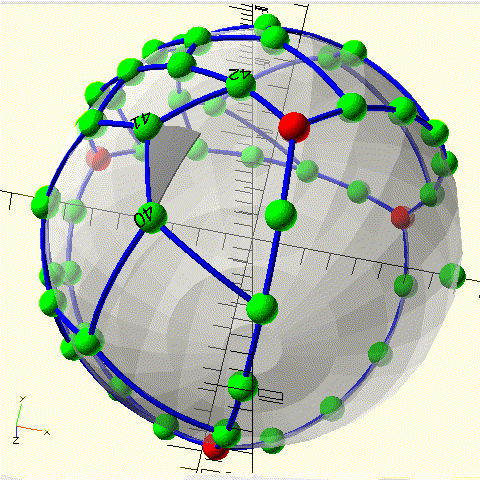

I created system of linear equations and did setup for solving just one side of the cycle.
I did that by fixating all non-visited vertices to a position outside of that side (on the opposite side, hidden by white sphere).
First I tried with coordinates in 0°..270° range, result looked interesting, but not crossing free.
So I thought that I might have chosen the wrong side, and that was right.
Forcing to the other side is simply done by adding of 360° (2π) to all phi angles with coordinates <=90°.
forall_vertices(G, function(v) {
    if (coords[v][0] < Math.PI) {
        coords[v][0] = coords[v][0] + 2 * Math.PI;
Now solving system of linear equations with range 180°..450° produced crossing free unit sphere embedding for the first time !
Until now it was OK that OpenSCAD "edge" implementation is a (straight) cylinder, perhaps a bended cyclinder along unit sphere would be better.
Here is embedding of one side of tetrahedron shortest paths cycle, from two viewpoints:
(not drawing the computed vertex positions vertex ball is intenionally for now, to clearly see the cycle vertices)

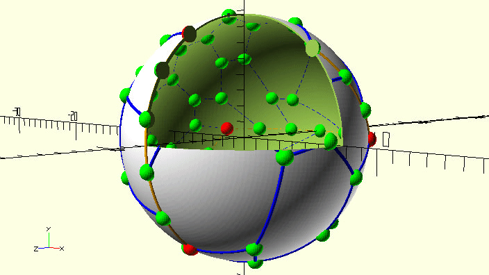

It is essential to have round edges, along the sphere surface, to avoid straight line edges through trhe white inner sphere.
New OpenSCAD module "edge2()" works correctly for many edges (eg. left), and wrong for others (right).

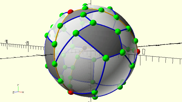

In case somebody wants to look into this round edge issue, code is not good enough to commit+push yet.
New tuttte.js has been committed and pushed before, current "node.tetra.js" dump at bottom of this posting.
Call for edge 19 to be blue:

Results in this display in OpenSCAD with file "x.scad" opened:
(gets updated on each execution of "node.tetra.js")
Function "srad2deg()" converts the JavaScript spherical [phi,theta] coordinate in radians to degree for OpenSCAD:
function rad2deg(r) {
    return r / Math.PI * 180;
function srad2deg(p) {
    return [rad2deg(p[0]), rad2deg(p[1])];
This is central edge drawing function, painting "edge()" and "edge2()" as blue ("sele" is number of edge to draw blue):
    forall_edges(G, function(e) {
        if (visited[source(G, e)] && visited[target(G, e)]) {
            if (e===sele) { wlog("color([0,0,1])"); } else { wlog("color([0,1,0])"); }
            wlog("edge(", scale_3D(map_3D(coords[source(G, e)][0], coords[source(G, e)][1]), sc), ",", scale_3D(map_3D(coords[target(G, e)][0], coords[target(G, e)][1]), sc), ");");
            if (e===sele) {
                wlog("edge2(", srad2deg(coords[source(G, e)]), ",", srad2deg(coords[target(G, e)]), ",", sc, ");");
Here dump of "node.tetra.js" as is — any help in diagnosing how "edge2()" needs to be modified to be correct is appreciated:

I determined all the alphas, sigmas, lambdas, ... and "edge2()" got really big:
    wlog("module edge2(p1,p2,sc) {");
    wlog("    la1 = p1[0];");
    wlog("    la2 = p2[0];");
    wlog("    l12 = la2 - la1;");
    wlog("    ph1 = 90 - p1[1];");
    wlog("    ph2 = 90 - p2[1];");
    wlog("    al1 = atan2(cos(ph2)*sin(l12), cos(ph1)*sin(ph2)-sin(ph1)*cos(ph2)*cos(l12));");
    wlog("    al0 = atan2(sin(al1)*cos(ph1), sqrt(cos(al1)*cos(al1)+sin(al1)*sin(al1)*sin(ph1)*sin(ph1)));");
    wlog("    s01 = atan2(tan(ph1), cos(al1));");
    wlog("    l01 = atan2(sin(al0)*sin(s01), cos(s01));");
    wlog("    la0 = la1 - l01;");
    wlog("    s12 = acos(sin(ph1)*sin(ph2)+cos(ph1)*cos(ph2)*cos(l12));");
    wlog("    translate([0, 0, 0]) rotate([0, 0, la0+180]) rotate([al0+90, 0, 0]) rotate([0, 0, s01-90])");
    wlog("        rotate_extrude(angle=s12, convexity=10, $fn=100)");
    wlog("            translate([sc, 0]) circle(0.1, $fn=25);");
    wlog("}");
I don't know why I had to add 180° to 1st rotate, add 90° to 2nd rotate and subtract 90° to 3rd rotate.
But for edge 33 of C40 it draws the round edge (of length sigma_12 or s12) correctly:
pi@pi400-64:~/planar_graph_playground $ ./rjs node.tetra.js graphs/C40.a white 33
12 pentagons for graph
10 non-pentagons for graph
vertices: 0,4,24,30
max: 28
dists: 4 5 5 5 5 4
edges: 2,3,6,7,0,18,17,24,26,9,30,32,48,49,40,41,52,50
vertices: 0,4,24,30,1,3,2,16,17,28,29,31,32,23,13,12,8,9,5,6,7,14,15,25,26,27,33,34,35,36,37,38,39
M.length: 33
But for all other edges that does not work.
"rotate([0, 0, la0])" should move the start of round edge to point A(0, lambda_0) on equator:
"rotate([al0, 0, 0])" should rotate azimuth to alpha0.
Finally "rotate([0, 0, s01])" should move round edge from point A to P1, and end of round edge should be P2.
I will have to select another edge for investigation whether that works, or which other modification is needed for that edge.
At least the Wikipedia pages I pointed to seem to have all the formulas needed for "edge2()".
P.S:
I did set view temporarily to this instead of "[0,0,0]" to have edge 33 always directly in view:
wlog("$vpr = [90,0,110];");
OpenSCAD displays "rotate = [...]" at bottom, so I rotated target view manually and used the angles reported from then on.
P.P.S:
I made the 3rd rotate a noop by "rotate([0,0,0])".
alpha_0 as well as lambda_0 (of point A) are good, for all edges I tested, here for edge 36:
Seems that sigma_01 (s01) does not get computed correctly ...

It was a herd fight to get OpenSCAD "edge2()" work in all cases.
I tested with C20/C40/C60 and C36.[4/7/8/11/14].
I found failures of edge2() in many of those graphs.
Edges near north pole, south pole, edges with big s01, edges crossing equator, ...
It turned out that OpenSCAD does not allow to assign to outer scope variables in if/else statements.
I ended with 6 cases and even these 6 case did not fix all edges in the test graphs.
Finally it turned out that it is better to move directly to P1 instead of to P0 on equator first:
stammw@t480ub:~/planar_graph_playground$ diff old new
17c17,18
<     translate([0, 0, 0]) rotate([0, 0, la0]) rotate([90-al0, 0, 0]) rotate([0, 0, s01])
>     translate([0, 0, 0]) rotate([0, 0, la1]) rotate([0, -ph1, 0])
>       rotate([90 - al1, 0, 0])
All changes are contained in just pushed commit:
(so you can play with as well, with "x.scad" opened in OpenSCAD)
https://github.com/Hermann-SW/planar_gr ... 15a5d0e3b9
Complete "edge2()" is here:
https://github.com/Hermann-SW/planar_gr ... js#L61-L81
I just deleted lines for now unused variables al0, s01, l01 and la0, and all still works:
https://github.com/Hermann-SW/planar_gr ... js#L70-L73
Running "./rjs node.tetra.js graphs/C60.a white" sphere embeds half of C60 now correctly with round edges:
Time to not draw straight line (green) edges anymore.
I have already implemented computation of all vertices on the 6 tetrahedron shortest paths, but that file is on my Pi400.
Will add working "edge2()" to that tomorrow when back home.
Then with "shortest paths face traversal" technique applied to the 4 tetrahedron triangles, I should get convex graph embedding onto the sphere of planar graphs for the first time.
P.S:
When I will get a nice C60 embedding onto sphere, I will export as STL and 3Dprint with my Prusa MINI+ ... (just the sphere embedding with vertex spheres and rotate_extrude edges, without "white" option)

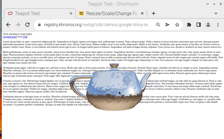

Now that convex face sphere embedding is nearly done, I asked myself whether in addition to OpenSCAD output 3D output in browser can be done as well.
And the answer seams to be WebGL, here are several demos:
https://www.khronos.org/webgl/wiki/Demo_Repository
I played with shiny-teapot demo, and that provides mouse (or finger on Android) controlled 3D rotation:
https://registry.khronos.org/webgl/sdk/ ... index.html
On Pi400 peek screenrecorded:
I did disable "Use hardware acceleration when available" in Chromium, and still teapot demo works nicely.
So I will have to learn how to use WebGL in addition to OpenSCAD for interactive sphere embedding 3D output in browser.

I learned from @caterpillar on twitter yesterday that there are other options for great circle OpenSCAD arcs:
https://twitter.com/caterpillar/status/ ... 8914697216
I like his rotate_extrude based solution from today:
I just adapted the white sphere radius to "sc" instead of "sc-0.5" as @caterpillar did (by adding 0.5), just changing last line in generated x.scad:
color([1,1,1,0.5]) translate([0,0,0]) sphere( 7.245966692414834+0.5 );
I added 50% transparency as well, which allows to see all edges, while still knowing which are on front half sphere and which are on back.
Vertex spheres as well as great circle arcs are half sunken in white sphere, but that looks OK even without transparency.
Here again two tetrahedron triangles filled with computed position vertices of C60 fullerene, the 4 tetrahedron vertices are the red ones:

One step back to non-tetrahedron version, adding debuggability features!
I learned that right clicking a (straight or rounded) edge or a vertex sphere shows a stack trace window in OpenSCAD.
Clicking on any line in stack trace highlights the corresponding line in OpenSCAD source code.
Until today that showed spherical parameters passed, not helpful in debugging graph vertices and edges.
With latest commit pushed now useful debug information becomes available:
https://github.com/Hermann-SW/planar_gr ... acac5dd5f8
The trick was to move functions "map_3D()" and "scale_3D()" form NodeJS into OpenSCAD.
So what does this allow for?
Here the three new debug options, first for right clicking on a vertex.
Clicking on "vertex()" line in stack trace highlights the corresponding line in OpenSCAD source code:
As you can see in copied in left bottom line 319, the stack trace left top vertex is vertex "1".
This shows right clicking on a (not used later) straight line edge.
Clicking on "edge()" line in stack trace highlights the corresponding line in OpenSCAD source code:
As you can see in copied in left bottom line 120, the stack trace left top edge is edge between vertex "1" and "39".
Last right clicking on a great circle arc edge.
Clicking on "edge2()" line in stack trace highlights the corresponding line in OpenSCAD source code:
As you can see in copied in left bottom line 122, the stack trace left top edge2 is between vertex "1" and "39" as well.

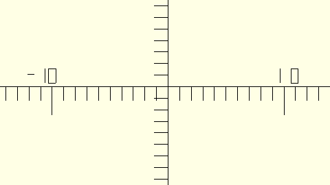

Just learned how to use OpenSCAD "text()" module, how to make text flat, rotate and move into position and align:
https://en.wikibooks.org/wiki/OpenSCAD_User_Manual/Text
With latest commit I added "vtxt()" module, that places vertex number in front of vertex sphere:
https://github.com/Hermann-SW/planar_gr ... da6721e424
A bit tricky, but with the pieces I already had from "vertex()" module not that difficult:
I appended these lines manually and pressed F5 to preview:
vtxt(39);
vtxt(52);
vtxt(53);
Rotation demonstrates the result:

Another slight sidetrack.
For planar convex face straight line drawings the 12 pentagon faces got colored grey.
I wanted to have the same for the sphere pentagon faces.
What is needed here are spherical polygons, and they are most easily built from spherical traiangle.
https://en.wikipedia.org/wiki/Spherical_trigonometry
Yesterday I was able to create OpenSCAD module that draws a spherical triangle with two same length sides:
Today I made use of that to create "module sp_tria(_p1, _p2, _p3)" that draws triangle for the three vertices _p1, _p2 and _p3.
It does some graph computations, and then call modified module from yesterday, with radius, theta and phi angles, thickness and number of segments in both directions:
module sp_tria2(r, tang, pang, thi, ord, ord2) {
    ang= [ for (i = [0:ord]) i*(tang/ord) ];
    rang=[ for (i = [ord:-1:0]) i*(tang/ord) ];
    coords=concat(
        [ for (th=ang)  [(r-thi/2)*sin(th), (r-thi/2)*cos(th)]],
        [ for (th=rang) [(r+thi/2)*sin(th), (r+thi/2)*cos(th)] ]
    rotate_extrude(angle=pang, $fn=ord2) polygon(coords);
The trick is to use "sp_tria2()" two times along the longest triangle edge.
Both do overlap a bit, but fill complete triangle area.
Last image from animation zoom shows that it really is a (round) sphere triangle:
(execute "./rjs node.tetra.js graphs/C60.a white" and open "x.scad" in OpenSCAD)
Next step is to implement corner cases, and to implement "openscad_fill_face()" to draw #vertices(face)-2 spherical triangles.
P.S:
I commited and pushed snapshot as is, much cleanup needed, but works as the animation shows:

With latest commit+push I fixed most of the circles by forcing angle differences into -180..180° range with this OpenSCAD function:
https://github.com/Hermann-SW/planar_gr ... ra.js#L151
    wlog("    function m180(ang) =  (ang < -180) ? 360 + ang : ((ang > 180) ? ang - 360 :ang);");
But some round overshoots remained, and reason was that "tria2()" did not create spherical triangle, but because of (needed) rotate_extrude one side is round. I determined centroid of three vertices and normalized it onto unit sphere. Then I placed a small 0.1 radius blue sphere there (for debugging only). Because the grey spherical construct is 0.1mm thick, a little blue can be seen on top (left):
I did dot products of the 3 triangle vertices with their centroid on unit sphere, and determined minimal value mi:
https://github.com/Hermann-SW/planar_gr ... #L158-L167
    wlog("        ms = v1+v2+v3;");
    wlog("        ms2 = scale_3D(ms, 1/sqrt(ms*ms));");
    wlog("        mi = min(v1*ms2, v2*ms2, v3*ms2)-0.1;");
    wlog("        sv1 = scale_3D(v1, sc);");
    wlog("        sv2 = scale_3D(v2, sc);");
    wlog("        sv3 = scale_3D(v3, sc);");
    wlog("        s1 = scale_3D(sv1, 1/mi);");
    wlog("        s2 = scale_3D(sv2, 1/mi);");
    wlog("        s3 = scale_3D(sv3, 1/mi);");
Then I scaled the 3 vertices with reciprocal of mi, lifting all vertices on plane with blue dot.
As can be seen the convex hull of these 6 points completely contains all of the good spherical part for triangle.
So union of both "tria2"s
https://github.com/Hermann-SW/planar_gr ... #L170-L182
    wlog("            union() {");
    wlog("                color([0.5,0.5,0.5]) translate([0,0,0])");
    wlog("                    rotate([0,0,la1-180])");
    wlog("                    rotate([0,ph1-90,0])");
    wlog("                    rotate([0,0,-al13])");
    wlog("                    sp_tria2(sc, s12, m180(al13-al12), 0.1, 40, 40);");
    wlog("                    rotate([0,0,la3-180])");
    wlog("                    rotate([0,ph3-90,0])");
    wlog("                    rotate([0,0,-al31])");
    wlog("                    sp_tria2(sc, s23, m180(al31-al32), 0.1, 40, 40);");
    wlog("            }");
intersected with convex hull of 6 vertices
https://github.com/Hermann-SW/planar_gr ... #L169-L192
    wlog("        intersection() {");
    wlog("            hull() {");
    wlog("                translate(sv1) cube(0.01);");
    wlog("                translate(sv2) cube(0.01);");
    wlog("                translate(sv3) cube(0.01);");
    wlog("                translate(s1) cube(0.01);");
    wlog("                translate(s2) cube(0.01);");
    wlog("                translate(s3) cube(0.01);");
    wlog("            }");
    wlog("        }");
keeps correct spherical triangle for the three vertices and nothing else!
I changed white sphere to be 0.1 thick difference of spheres with radius sc and sc-0.1, and moved that code to end:
https://github.com/Hermann-SW/planar_gr ... #L227-L232
    if (white) {
        wlog("difference() {");
        wlog("    color([1,1,1, 0.5]) translate([0,0,0]) sphere(sc);");
        wlog("    translate([0,0,0]) sphere(sc-0.1);");
        wlog("}");
This allows to see bottom of grey spherical polygons on "other side" of sphere as well:
Here is different view after rotation of same graph:
Now that vertex labels and spherial polygons for the grey faces (colored faces for 6-coloring of planar graph later) work, it is time to combine the two parts of shortest paths tetrahedron to compute and embed all vertices of the graph on the sphere together ...

I played a lot and did not get combined sphere coordinate placement correct until now.
So I went back and added parameter handling, with new options -5..-2 for selected edge:
https://github.com/Hermann-SW/planar_gr ... 99224b2797
$ ./rjs node.tetra.js graphs/C60.a white.50 -5
-5: left+up, w/ pentagon vertex lables
-4: right+bottom, w/ pentagon vertex lables
-3: left+up, w/o pentagon vertex lables
-2: right+bottom, w/o pentagon vertex lables
Front and back of right+bottom without vertex labels, with non-transparent white sphere:
./rjs node.tetra.js graphs/C60.a white -2

Sidetracked again, but for good. Adding 2 mirrors to scene allows to see all of the sphere the whole time!
You can follow the isolated green vertex during whole rotation, over central sphere, in left mirror and in right mirror:
viewtopic.php?p=2025118#p2025118

I used shortest paths tetrahedron sofar in order to process the vertices in each triangle (left):
But I processed left+top together, as well as bottom+right.
So today I removed two of the six tetrahedron shortest paths from fixated on sphere vertices.
Because I did solve system of linear equations for each doit() call, the separating circle now reflects that.
This is part of latest commit+push:
https://github.com/Hermann-SW/planar_gr ... e51b5a1d17
 coords2 = doit(false);
+var evisited_ = evisited;
 M = M.slice(0,4);
 coords3 = doit(true);
+forall_edges(G, function(e) {
+    evisited[e] = (evisited[e] && evisited_[e]);
Basically evisited[e] is true by this, if and only if it is an edge of the separating circle.
With latest commit those edges are drawn orange, all other edges are drawn blue.
Here you can see that the vertices between two pairs of the red tetrahedon vertices are not on a great circle anymore:
(the orange edges are)
In this animation you can follow the separating circle orange edges completely:
The 4 tetrahedron vertices were determined really inefficiently in O(|V|⁴) runtime:
https://github.com/Hermann-SW/planar_gr ... s#L91-L113
I can replace that by an efficient algorithm that finds a circle in planar graph that has roughly the same number of vertices inside and outside (for even distribution of sphere spring embedding). That circle can be long or short (that would fixate only few vertices). All separating circle vertices will be fixated on sphere as shown in top screenshot right side, then the remaining vertex positions will be computed by two "doit()" calls.
P.S:
Just searched Wikipedia and found planar separator theorem, especially "simple cycle separators":
https://en.wikipedia.org/wiki/Planar_se ... separators
For a graph that is already maximal planar it is possible to show a stronger construction of a simple cycle separator, a cycle of small length such that the inside and the outside of the cycle (in the unique planar embedding of the graph) each have at most 2n/3 vertices. ... Djidjev & Venkatesan (1997) further improved the constant factor in the simple cycle separator theorem to 1.97 √n vertices.
Seems to be what I want ... a non-maximal planar embedding can be triangulated easily.
P.P.S:
The great circle arc length between the 4 red vertices is 108°.
Because there are 5 green vertices between the two horizontal red vertices, spherical arc (edge2) between two neighboring is 18°.
The animation was created with 20 steps, so a step has 360°/20=18° as well.
That is the reason why the vertices between the two horizontal red vertices are mapped on another with each animation step.

Instead of using pentagon spherical polygons of C20, making white sphere thin might allow to 3Dprint all planar graphs sphere spring embedded.
I generated OpenSCAD "look_inside" variable defaulting to false. When changing that to true in OpenSCAD, a cube will be subtracted and a look into inside is possible.
The look inside revealed that there are vertex sphere parts inside not needed for 3Dprinting, since they cannot be seen.
Newly generated "diff_last" variable is false and subtracts sphere of redius "sc-0.1" from sphere of radius "sc".
That is fast, but has the inner stuff.
Setting "diff_last" to true leads to huge initial runtime and every rotation gets very slow.
But the effect is as wanted, see right.
So operation will be to generate x.scad, inspect quickly in OpenSCAD, and if all is fine to set "diff_last" to true and then press F6 to render for following export as STL and 3Dprinting.
This is the small diff that added the new features:
https://github.com/Hermann-SW/planar_gr ... 8bbd107c10
Edges have radius 0.1, while white sphere is 0.1 thick. Therefore edges look out 0.1 on outside. On inside tip of blue edges can be seen left:
I could not resist to create an animation with look_inside set to true:
